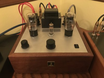

Reply #7 on: June 23, 2018, 02:57:18 AM
what just happened….?
Tubes came in from Brent Jesse (Chicago supplier - good guy) and I warmed up the soldering iron.
I read nothing but good about the 45 tubes.  The mod took almost 15 minutes, everything checked out.  Used the headphone adapter to adjust the hum pots and just left it in for fun.  2 hours later the silly grin had yet to leave my face!
Moved in the speakers, just a pair of Boston Acoustic A60 Series I's I rehabbed.  Another hour disappears, silly grin remained.
Much less power, noticeable with these speakers, much more magic - noticeable with anything I plugged into it.
I read I can still use the 2a3's but at a reduced power level?  I would like to do some swapping and compare.  Right now I can't put a finger on the magic but it's there.
