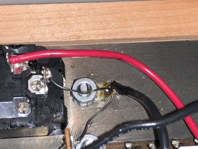

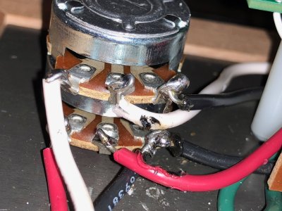

Reply #3 on: June 18, 2018, 12:03:24 PM
I've attached some picks of my build, which I know looks like it was put together by a chimpanzee with epilepsy.  But since this was my first ever DIY project, I'm amazed I got anything to work at all.  ;D I've included shots of the potentiometer joint, the 9-pin socket, and the ground tab, which right now is showing infinite resistance.  As you can see, I've made a hash out of the wires around the potentiometer joint trying to reflow the solder.

Reply #4 on: June 18, 2018, 12:51:13 PM
You need to reflow all of your solder joints. Make sure that the tip of the iron is touching both the wire and the terminal, and make sure the solder flows onto both and makes a fillet at the joint. The safety ground tab is particularly bad, but there are several others that need a reflow as well. Just do them all and you will probably be in good shape.

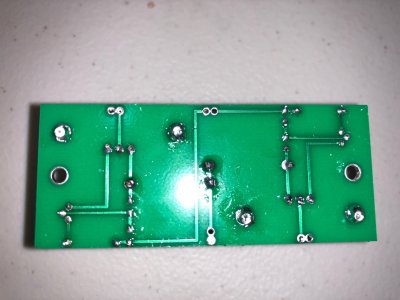

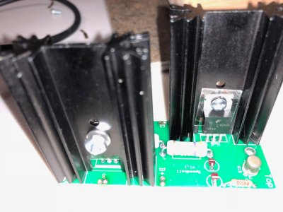

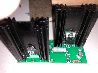

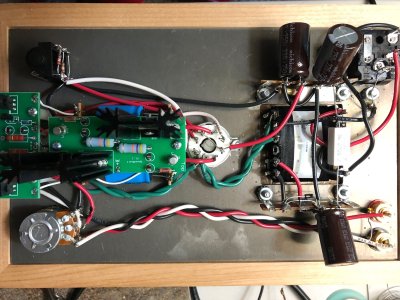

I ran the amp with no 6080 and the voltages on the small board look correct.  However, the LED closest to 1A still doesn't light up.
I've attached pics of my large board.  I don't see anything wrong with the joints but maybe I'm just not looking for the right thing.
Manny Rodriguez
First time "DIY-er"
Offline Tom-s
    • Posts: 505
Reply #10 on: July 03, 2018, 11:14:06 AM
If i look at your board i'd reflow both center lugs of the TIP-50 transistors (both).
Reply #11 on: July 03, 2018, 11:29:12 AM
You have two LEDs with bad solder joints. Just reflow everything on the board.

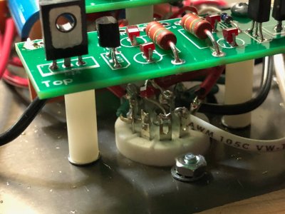

Reply #13 on: July 04, 2018, 05:41:11 AM

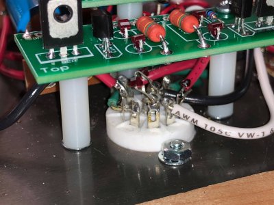

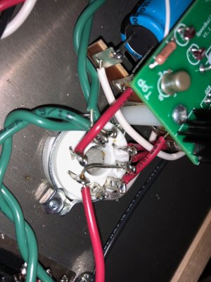

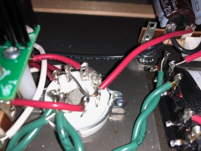

Can I see a shot of the octal socket area?
What you're experiencing with the big board seems a lot like the TIP50 transistors aren't installed properly, but you have voltages at OA and OB that aren't the 0V that I would expect from this issue.
The other problematic situation is when the B+ wire for the big board isn't connected to the correct terminal.
Offline aztlan667
    • Posts: 8
Reply #14 on: July 04, 2018, 08:12:00 AM
Here are a couple pics.  I've re-flowed all of the octal and 9-pin connections as well, with no effect.
I'm fairly certain that the TIP-50 transistors are installed correctly.  They're oriented just like it looks in the manual.  Also, the B+ wire is terminated to 4U, per the manual.
