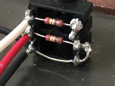

Terminals 6 and 10 are grounded by the headphone jack when no headphones are plugged in.  I would guess that the junction of the black wires on the headphone jack isn't all the way soldered, so terminals 6 and 10 are grounding through the 2.49K resistors instead.

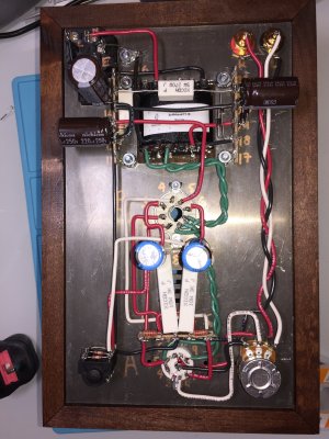

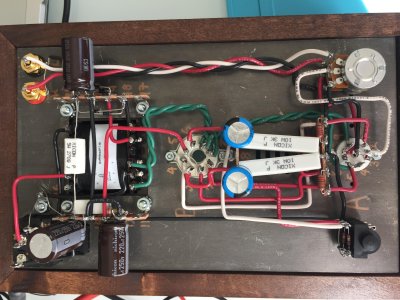

Wow, that's very nice wiring!  I love how you straightened the runs and made such careful bends.
I'm going to refer back to your picture when doing mine.

Very kind - it helps me see whats what but I must have errors some where, as after the weekend I've come back to the build and I've blown a fuse and now have climbing resistance figures!...

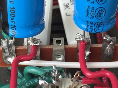

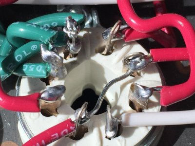

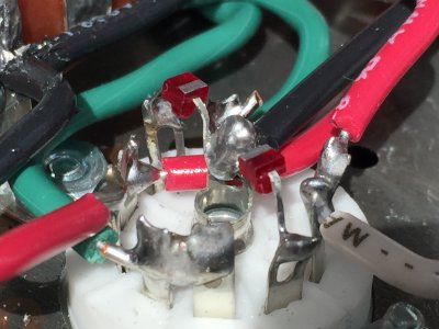

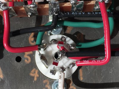

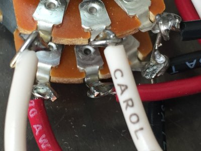

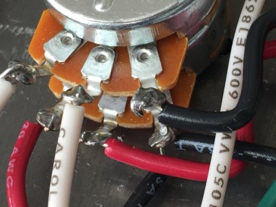

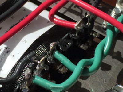

If the green wire going to A4/5 touches terminal A6, then you'll have some issues.  I can't tell if this is happening or not, but I'd move those apart a bit and do a little trimming on those socket lugs.

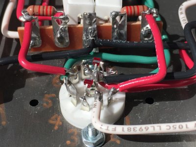

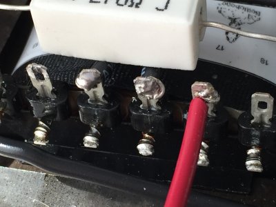

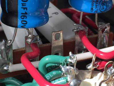

It looks like either you are using lead free solder, or not enough heat (maybe both). When I look at terminals 3U and 3L, I would cook those more until the solder flows smoothly.

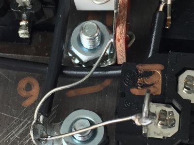

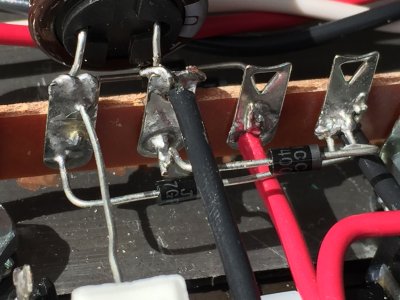

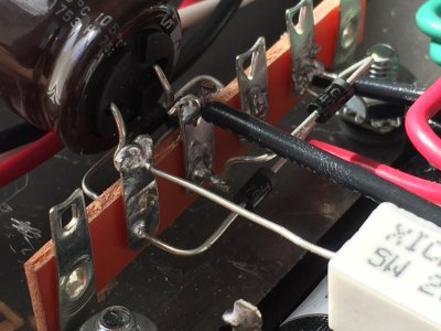

The UF4007 diodes that are on the inside of the 6 lug strip (above the power transformer) are not mounted in a manner that's consistent with the instructions.  If two leads on two different diodes are touching, and those leads go to different terminals, then you'll blow fuses until your power transformer dies.   There's a big warning with red letters on the top of page 38 warning about this exact situation.  The body of the second UF4007 diode needs to sit against the lead of the first, and they need to be mounted just like the manual shows.

I'll re-do those UF4007 diodes too and hopefully I'll report back with success!

With leaded solder and that hot of an iron tip, you'll get good joints.  You'll see when you heat the joint enough that the solder turns into a runny liquid and wicks into the gaps between the terminals and your component leads.

Also check to insure you didn't solder the insulation instead of the metal.  I've done this a few times getting the wires exactly the right length and ended up with an open connection.  I like the look and it appears you're on the same track but it can give you issues.
Nice wiring layout!!

Thanks every one for great fast and clear advice! I desoldered those diodes with some wicking copper and trimmed and bent them to spec before re mounting them and ta da! all working!...

Out of interest though why does trimming the legs to certain lengths and making the diodes touch make a difference? I had the same circuit "on paper" before as far as I can figure out?

It's quite possible for leads of adjacent diodes to touch, and if the wrong two leads are squished together, that shorts out the HV supply.
When you put one diode close to the terminal strip and then the body of the other up against the DC side of the first diode, you greatly reduce the chances of this happening.

Is there a particular reason everyone is ignoring the fact that the diode 21L->18L diode was installed backwards, the error was corrected, and THAT is why the amplifier is no longer blowing fuses?
