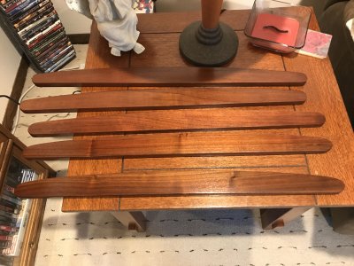

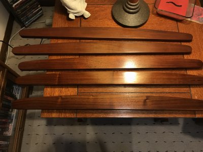

I just used powdered die for the first time and it came out very nice.  I used a medium color on some DQ-10 walnut side boards I've had for some time (now to sell them!).  I also used a very dark color on an alder base for the Crack-a-two-a and with the silver plate that came out very nice.  A bit too dark to show the grain but that combination was great.
Sand down to near perfection with at least 220.  Then do wet it and allow that to dry, then resand with 220 or higher.  This will allow the grain to pull up and be sanded back down before you apply the die.
My brother uses die all the time and told me that if it appears too dark you can go back over it with a wet cloth to thin back the color.  That I've not tried yet.
My surprise was that for the final finish I used tung oil, final result was amazing!

Attachments are of the DQ-10 sides,  died with Medium something... (I don't remember) and then about 10 or 12 thin coats of tung oil.

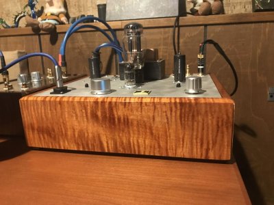

Offline ALL212
    • Posts: 542
Reply #7 on: June 26, 2018, 05:56:20 AM

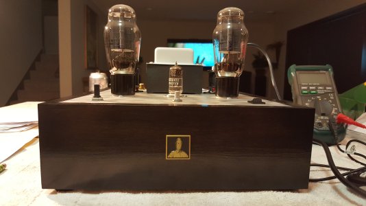

I used Dark Oak on this alder box and it is dark but it made the top plate pop.
I also had Colonial maple and Medium Walnut.  The cool thing is you can mix the powders to your own custom colors.
I think the walnut DQ-10 sides were died colonial maple but I'm not sure.

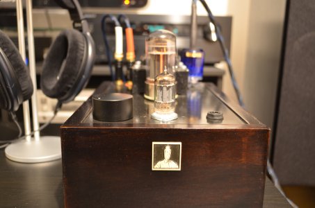

Reply #8 on: June 26, 2018, 08:34:46 PM
I used Varathane fast drying stain in Ebony. I love the dark color. The base needed little prep, just a little touch with 220 paper, then I think I used a Zinsser shellac, IIRC.
The photos aren't great, but you get the idea.
Ben

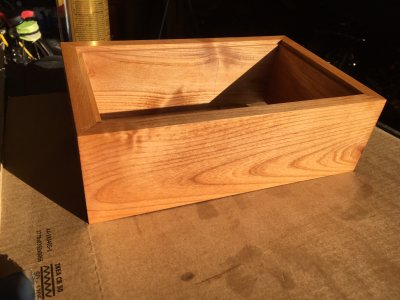

Reply #9 on: July 04, 2018, 04:20:14 PM

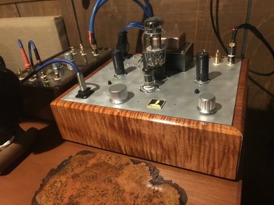

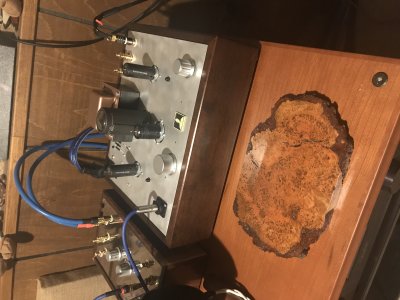

This one is Colonial Maple die in a special cut of cherry.  Nothing extra applied other than tung oil - maybe a dozen or more layers.
The fine gentleman that cut this forgot to calc in the kerf so I've got some corner work to do yet.
« Last Edit: July 04, 2018, 04:27:44 PM by ALL212 »

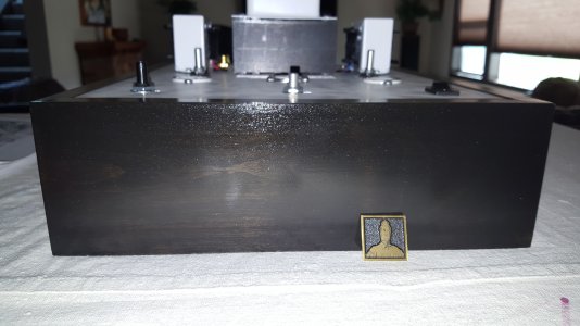

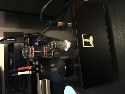

Offline Blue
    • Posts: 32
Reply #10 on: July 17, 2018, 11:16:29 PM
I really liked looking at everyone's designs, and it gave me some good ideas for the next project!
I'm already thinking of buying a second crack: one for my stereo setup, and one for my computer.
I've completed my crack over the last week (Thanks to Caucasian Blackplate for the help in debugging the speedball issue!)
I made lots of mistakes in the staining and varnish process. But the imperfections I can live with, and it's fun to know That I did it.
I've included two pictures. The stain turned out darker than I hoped. Turned much darker after I applied the varnish. But I still like it.
It was really fun to build the crack, would definitely recommend it to anyone!
