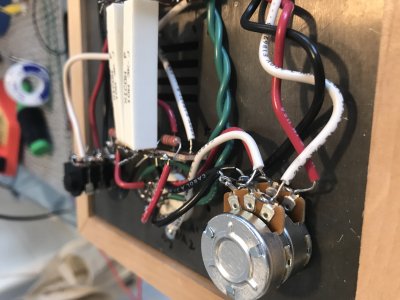

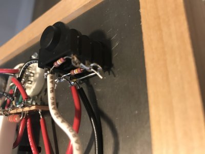

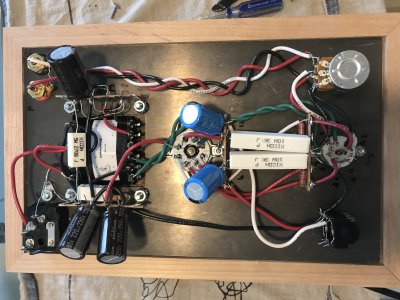

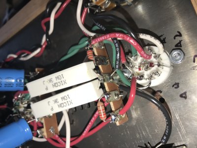

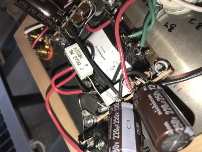

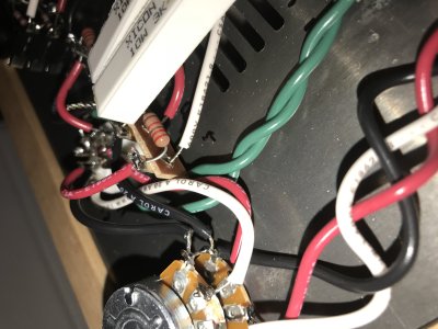

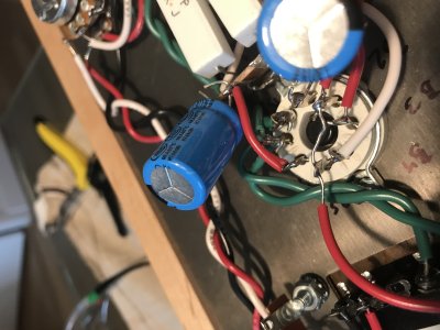

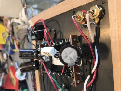

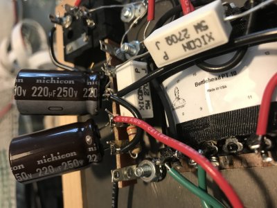

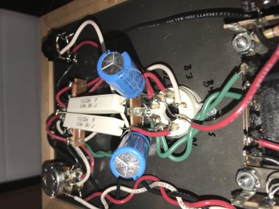

I uploaded a bunch of pictures. I am not sure what to focus on or what needs to be sign to help with the diagnosis, so I took a few from different angles. Happy to upload more if it helps. Thanks again to whoever reads this.

Here are a few things to do to get you up and running.
1.  When you install a component, you need to trim the leads.  The photos in the manual are a good guide for this.
2.  The wire at A7 has too much insulation stripped off (the manual calls for 1/4", that looks more like 1/2") and it's touching terminal A8.  We refer to this as a "short".  This should be remedied before you try powering up the amp again.
3.  The solder joint at A9 is likely preventing the 12AU7 from heating.  Did your amp pass the glow test on page 31?
4.  There's a component lead coming out of 9L that appears to be touching the chassis.  This will damage the amp if it does touch the chassis. (It looks like 7L has a similar potential issue)
5.  If the black wire leaving the headphone jack and heading over to terminal 3 is not secured by the solder at the connection to the headphone jack, you'll have some issues like those you are experiencing.
6.  2L and 3L need to be reflowed.  Make them look more like 4L.  Heat is your friend for this.
7.  The solder joint at B8 looks like it may not be functioning.

Reply #3 on: July 04, 2018, 10:59:02 AM
Thanks for your prompt response.
1. I did the best I could but the only tool I had to cute the leads was on my wire stripper and I couldn't do an adequate job clearly. I have some scissors that can get in closer to the joint but they won't cut through wire. Should I invest in another tool to clean up the stray leads? If so, what?
2. I tended to give myself extra slack later in the build since I was getting the insulation really close to the soldering joints. There is now space between A7 and A8.
3. The amp passed the glow test. Both tubes light up in on both sides.
4. Good eye! Both of the 10W 3K resistors have their wires sticking out because I didn't trim them short enough but I curved and curled them to ensure they are not touching anything.
5. The solder connection looks pretty thorough and complete to me. No visible gaps and when I tug, it's stuck pretty well.
6. I will give it a touch up.
7. Is there any way to test it? Should I add more solder? Maybe remove some?
Thanks again for your help, it's very much appreciated!
