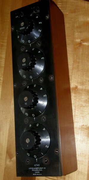

 I found a eerily similar box design for what I had planned to make originally a Fix circuit. Leeds & Northrup produced this decade box with four controls. Yes, I do hesitate to open it up and take out the precious parts that will no longer be used, but if I don't, then they go that way of being useless.
  So be prepared to witness the wedding of a Fix to it's distant cousin '4745'. Speak now or forever hold yer' piece.

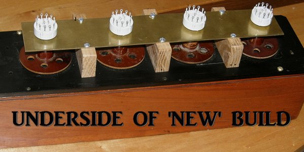

 This is the first step in re-purposing the original circuit. I am hoping that this is to be the most difficult step, since alignment of all four pots at the same time with the centers of each original knob was challenging. The rotation of each pot is acceptable. I drilled the holes for the shaft slightly over sized, so that when the epoxy was poured for each pot (not shown in this photo), there would be a little give here and there. It was a good idea, as I don't have much more than a drill press and a good eye to work with.
 Next step will be the mounting of the solder lugs to accept the capacitors and resistors.

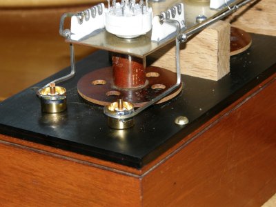

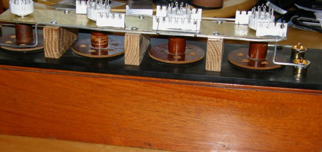

 Mounting the solder lugs was a challenge for big shaky hands. I got through it, but made a mess with epoxy that I had to clean up. I also used small screws that became the biggest challenge. So, I still have some solder gaps to fill, but the square grounding wire is in place. I know that the old guys had jigs for all of this bending, and I wish that I had the same! Every little thing shows here.
 Next I will solder in the caps and resistors.

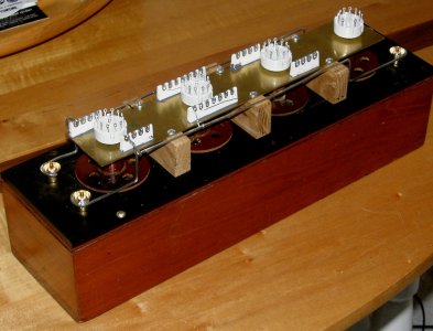

4krow
Reply #4 on: July 18, 2018, 12:58:42 PM
  Rather than include yet another photo, I will conclude this thread with my observations. As expected, I like having this unit available. I may even try it with headphones, just to hear a bit better the influence of the circuit. In my shop system, it was pretty easy to hear the difference that the BSC controls had over the bass. Simply put, bass notes were rounded out better than without the circuit. The treble side did not have the effect that I was hoping for. It is unfortunate that my hearing has taken a tumble so as not to be able to notice subtle differences anymore, but that is the way it is. Again, I might be able to tell with headphones on.
 The next step was to insert this unit into my main system since that is where I intend to use it. Fortunately, there is just enough room right behind the amp so that the unit fits neatly, out of sight, and can use the short interconnect cables recommended. I used 1/2 meter interconnects at the input of the Fix unit, and less than 1/2 meter interconnects from it's output to the amp's input. Yes, it makes quite a difference using too long a cable as I first tried out. So, the settings that worked best in my system were to have the treble setting at the 4db position, the 5k was the chosen position, and then for the bass, the 4db BSC position, and a 6"-12" baffle size. What I was actually hoping for is a bit more bass, which worked out nicely, and a 'Reduction in the Midrange'. Might sound backwards to some, but that is exactly the problem that I have with these drivers. They exhibit a bit more shout than I care for. After a good breaking in, that seems to have been reduced, but with the addition of the Fix circuit, it is the right level now for my ears.... In the future, I will complete my other project that marries a Quickie pre-amp with a Fix circuit in one chassis, and I bet it works out even better (Remember, I call it the Q-Fix)
