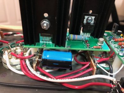

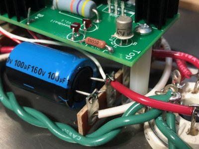

Post some pictures of the wiring. Something is wrong because the voltage should bleed off the caps when the amp is turned off.

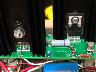

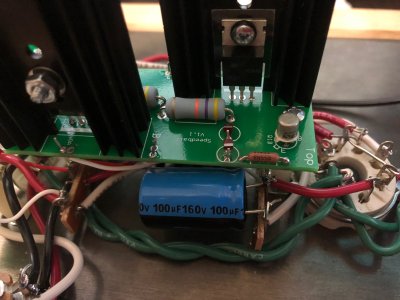

If you look at the TIP50 on the top side of the board in the A half, notice that the center leg looks like it pokes down into the solder, whereas the legs on other side have little solder cones going up the legs?  This is a visual clue that the TIP50 is not all the way soldered.

In the last photo you posted, the center legs of the TIP50 transistors still don't look properly soldered.
