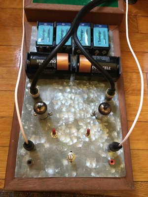

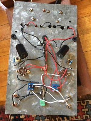

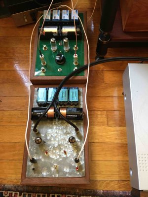

Finally had time to wire up the recommended changes today due to the holiday.  Kept the cathode tied to the bottom of the 9v stack but moved the ground with input and output tied to the top of the bottom battery for the 9v bias.  3.9k resistor "loads" on the cathodes.  2.2uF cap on the output with 470k to ground (the elevated ground).
It works great!  Thanks so much for your input PJ and PB!  I have to say, this gives the Quickie with ccs a run for the money, at least when using a higher powered solid state amp (I haven't tried anything else yet).  The key thing for me is that with a higher powered amp, I get very little in the way of microphonics or other noises with the cathode follower version.  I get a tiny bit of hum but that may be because my RCA's are junk bin parts with no isolation from the top plate.  So there may be ground currents flowing in the plate?  I'm REALLY glad I tried this and I highly recommend it.  Truth be told, I don't really notice any reduction in gain.  I still have plenty to work with. My only question is will my useful battery life be at all reduced since my plate sits at only 26-27v instead of 36v.  A small drop in battery voltage would drop the absolute voltage at the plate to pretty low levels.  I know the tube still has 36v going through it due to the -9v cathode, so maybe it's only relative voltage that matters.  So should it be the same battery life?
Time to consider an official cathode follower version of Quickie?  My answer would be yes... 8)
This build started as a breadboard but I find the clip lead approach to be less than ideal.  I liked what I heard enough in the breadboard stage to go ahead and start a semi-finished build. I used a piece of galvanized tin I had around, junk box parts, and the bottom third of the wooden box I built for the original Quickie.  The original box was too tall so I cut it down and kept the bottom piece.  Perfect for this project.  Left switch is the filament batteries and right is the inputs.  I kept the gist of the Quickie layout for ease of the build. One photo shows my green Quickie in the background for comparison.  Anyway, here are some photos to whet your whistle:
