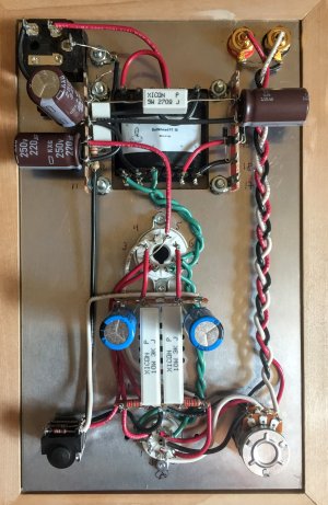

I finished wiring and assembling the Crack but wonder about some failed 0 Ohm readings in the ground path.
First, transformer voltages, glow test, and the resistances to terminals 7, 9, B3, B6, and RCA center pins all checked out. But I have issues where need a 0 Ohm resistance.
The leads of my DMM have a resistance of .6 Ohms, which I take as my baseline. Clipping one lead to U12, I get .6 Ohms readings at terminals 3, 6, 10, 14, 20 and the RCA ground. I get readings of 3-20 Ohms (measurements vary and are not consistent) on terminals 8, 22, 17, 16, 11, the ground tab, the screws that hold the transformer, the chassis. If I set my DMM to continuity, I do get beeps throughout.
If I clip the black lead to the ground tab and then measure the resistance to terminals 22, 17, 16, 11, 8, the chassis, or the screws holding the transformer I get .6 Ohms readings.
It seems that each individual ground path (black wire and chassis) are fine by themselves but don't seem to connect the way they are supposed to (0 Ohm instead of 3-20) Ohms. Where do they actually connect?
Although I seem to have continuity, I resisted the urge to put in the tubes and continue with voltage checks. Any thoughts?
Good.
You may be reading some resistance through the chassis plate, which is OK.  Tightening the screw on the front 5 lug terminal strip, the ground screw, and the transformer screws might be helpful.
The electrical ground (black wires) connect to the chassis at terminal 3 through the terminal strip.  The power transformer cover is grounded through the safety ground back by the IEC power entry module.  Seeing a little bit of extra resistance between those terminals and terminal 12 isn't that surprising, but I'd still tighten the hardware to be sure.
I would double check the black wires at the headphone jack.  The hole is rather large and hard to reach, and we frequently find kits where only one of the wires passing through there is soldered, which can give some unusual readings in the resistance and voltage checks.  If that joint looks good and the hardware is nice and tight, I'd go ahead and check your voltages.

Reply #2 on: August 18, 2018, 10:13:23 AM
Excellent, thanks so much for the prompt help!
It was exactly that screw at terminal 3 that wasn't very tight. That might explain the fluctuating resistance because I checked wires and connections and probably touched that strip multiple times, changing the resistance ever so slightly. I guess I was a little too careful when I installed the sockets. So, I tightened them all, and all values were great. Interesting that after all that careful soldering, counting turns per inch, braiding with love, and double checking all joints it was such a simple thing after all.
Headphone jack wires were all tight and good.
