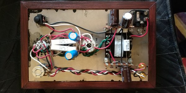

EDIT: I've attached a photo of my wiring in case it helps. Please note that I bridged A3 and A8, as I pulled one of the LED legs off during soldering :(. I've ordered another in the mean time.

You may just have a slightly microphonic tube, which isn't a cause for concern.

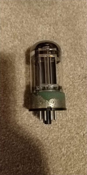

Is it likely to be the power tube or the output tube, and is there anyway of determining? The power tube is quite corroded on the outside - could this be the cause? I've attached another photo.

It's a physical attribute of some tubes.  If you tap on each one while the amp is operating, you might notice that one is far more sensitive.  In my experience, it's usually the 12AU7.  If you put the Crack on a heavier table or put a bit of weight on top of the power transformer on the Crack, this may reduce the microphonics to an acceptable level.  A wall shelf will also generally solve this issue.
12AU7 tubes aren't super expensive, so you could also buy a few spares if that ends up being the source of the microphonics.

Thanks. Tapping on the larger of the two tubes (this is the 6080, right?) seems to make significantly more noise. Presumably swapping this out will alleviate the problem?
    • Posts: 20297
Reply #5 on: August 30, 2018, 09:13:30 AM
It's certainly worth a shot, but the tube will otherwise operate and work just fine.
