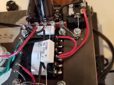

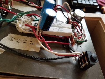

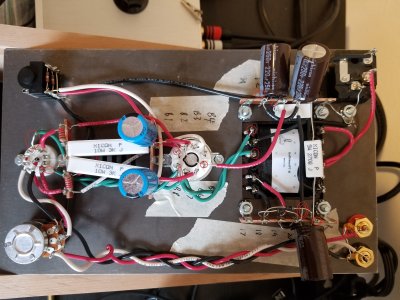

I got some pics this morning. If any other angles or closeups are needed let me know.
Thanks a bunch for the help!
    • Posts: 20292
Reply #3 on: September 14, 2018, 06:47:12 AM
I will circle all the problem areas in a few photos.
I'm not a huge fan of the way the ground wire has been run between the headphone jack and front 5 lug terminal strip.
Most of your wires are stripped way too far back, and these can eventually touch the chassis or other adjacent terminals.  This will cause future reliability problems.
Nearly all of your solder joints don't have anywhere near enough solder on them to be solid.  Don't be afraid of using a little bit more and holding the iron on the joint until it flows between the wire and the terminal.
