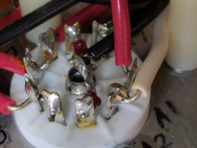

It's been quite a while since I have soldered anything, but I tried to reflow the center pin, and it is still behaving the same way; it works great as long as I don't touch the 5963. Could be the reflow didn't work because I am out of practice, or as you said, it could have been one of the other solder joints.
I've attached a couple of images of the 9-pin area after I attempted to reflow the center pin. I think I'm going to set aside some time to practice my soldering again, and give it another shot once I'm back up to snuff.
Based on the images, would you reflow all of the solder joints on the 9-pin section?

    • Posts: 20297
A5 is not adequately flowed.
