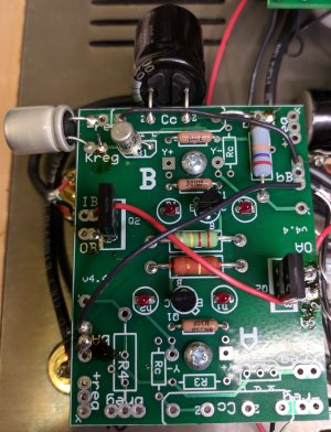

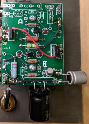

Photos attached, in case the names don't come through, the channel with the electros on top & left is good, the one with electros on bottom & right is bad.
    • Posts: 20260
Reply #8 on: October 09, 2018, 04:04:56 AM
I would look under the board as well for solder joints that aren't well flowed.
