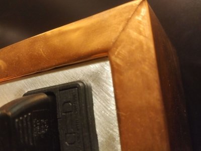

[Aside: I realize that this may be crazy, but after I clad my SII in copper I swear the sound changed.  And at that time I hadn't even thought of the "shielding" issue and wasn't expecting any sonic change - I just wanted a real copper encased amp because I like the looks of copper and I think it is representative of the incredible sound that the SII produces. But after letting the newly cladded amp warm up, I instantly thought I'd broken something b/c it sounded "off". But as I listened more, I concluded that it wasn't off, it was just different: the soundstage was smaller (not a plus for me), but there was better detail in the higher frequencies - I heard a few new details in music I am familiar with.  That said, the amp is still breaking in, so it may just be coincidence - or I am imagining it. Dunno.  It also occurred to me that the copper cladding, while it might be shielding the amp's innards from some EMI from the outside, might also be inwardly reflecting back EMI produced by the amp - I have no idea as I don't yet understand the nature of magnetic flux and other possible sources of radiated noise, or how copper shielding interacts with them. All of which is to say: I am aware that "shielding" could possibly worsen the sound of the amp.  But nothing I'm doing is irreversible.  After another month of burn-in, I will experiment with taking the cladding off - it can be removed without damaging it]

If the copper cladding on the base of your Stereomour touches the chassis (which I presume it does), then you have effectively extended the ground plane of the SII, which is certainly not a bad thing!

How can it touch the chassis and still allow the chassis plate to drop into the base?

It's very, very thin material.
