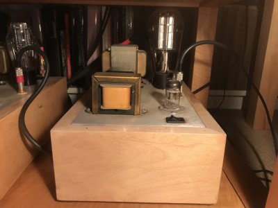

I've attached a photo of the unit.

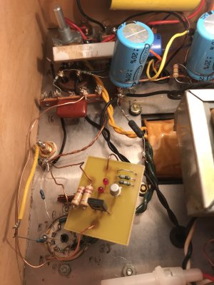

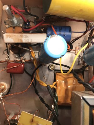

Three pictures of the underside attached. The soldering is not pretty - this was my first project, 18 years ago!
Voltages all check out with what's in the manual, but I have to wonder whether near zero volts on A3 (this is not listed in the manual) is a clue?

Interesting that you mention the coupling cap... at some point I upgraded this to an Auricap as you can see in the photo. It appears to be solidly connected at both terminals though.
    • Posts: 20290
Reply #6 on: October 14, 2018, 10:07:11 AM
The Auricap in your photo is the parallel feed cap, which is similar to what we refer to as the coupling cap, but it's on the output stage.  The coupling cap in your amp is the little brown box.
Speaking of, that resistor that connects to A3 and passes over A2 should be bent away from A2.  You don't want it to touch A2!
I'd add a little more solder to B6.  It's possible that the wire going from the C4S board to B6 is well connected, but the one leaving B6 is not.  B8 would probably benefit from a little extra solder as well.
