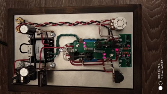

Hello! the upper right LED does not light
Terminal Voltage (DC)
OA 71V
IA 185V
B-A / B 0V
IB 185V
OB 57V
« Last Edit: October 21, 2018, 07:20:49 AM by Paul Birkeland »
    • Posts: 20296
Reply #1 on: October 20, 2018, 05:49:55 AM
This is on the smaller PC board?

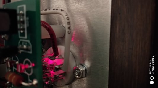

Do both LEDs remain lit on the 9 pin socket when you do this test (no need to mess with them either way).
Was the amp working OK prior to installing this board?
Offline Plumbum
    • Posts: 8
Reply #2 on: October 20, 2018, 07:21:47 AM
This is on the smaller PC board?  - Yes
Do both LEDs remain lit on the 9 pin socket when you do this test (no need to mess with them either way).- Yes

    • Posts: 20296
Reply #3 on: October 20, 2018, 07:22:49 AM
OB 57V
This means the front PC board isn't working.  Can you pull the rear PC board out and recheck this voltage?

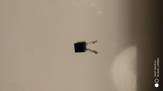

Reply #8 on: October 20, 2018, 10:05:53 AM
I broke the transistor... pn2907a, there are analogues? I'm in Russia

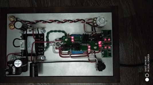

Yes! I am very grateful to you, thank you very much!

Reply #12 on: October 21, 2018, 01:17:14 AM
all perfectly!!! Thank you very much!
