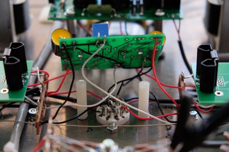

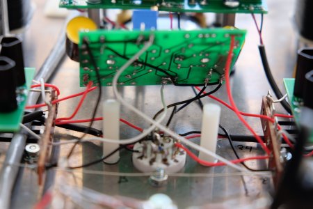

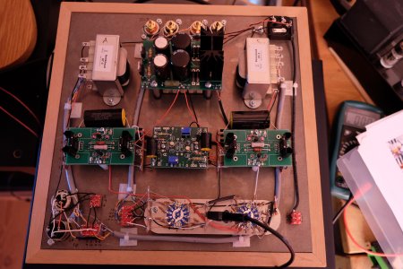

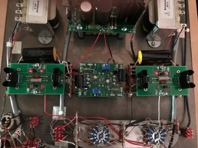

Here are some pictures

Reply #3 on: October 20, 2018, 05:39:57 AM
-Reg - A=0v B=1,89v
This jumped out rather immediately.  The -reg pads on each board are wired together.  It wouldn't be that weird to see 0V on one and 1.89mV on the other, but if you have 1.89V at -regB, then there's an issue with the ground jumpers on that board.
IB A 149
IB B 260
kreg - A=1,89v B=19,1v
What's interesting here is that neither high voltage regulator is working.  Inspecting your work, the wiring of B8 and B3 is incorrect. A black jumper on the bottom side of the PCB also looks to not quite be in the right place.

Reply #4 on: October 20, 2018, 07:50:22 AM
You are right on the money...
I corrected B1 and B3 and the jumper so now all the light show up and the currect reading are acceptable
