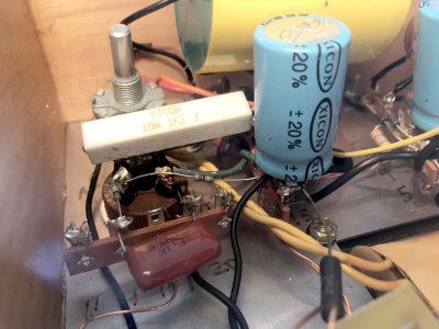

I think I MIGHT have the following connections right - could you guys please confirm from the attached photo?

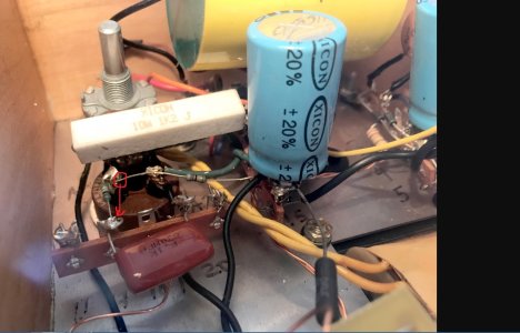

Here's an image to show one of the mods you speak of.
As far as heater winding ground references go, there's a green pair of wires leaving the power transformer and going to the 12 pin socket.  Those green wires will attach to some socket pins.  If those are the only things attaching to those socket pins, then the winding is floating.

I think maybe the image didn't attach?
On my amps, the two green leads are the only connections at the tube socket. So I'm guessing I should connect B9 to T14 as Paul Joppa proposed?
And what about the other mod - should the 270k grid resistor be moved from A3 to T17?
Reply #3 on: October 21, 2018, 07:18:31 AM
I got that image attached for you.
B9 to ground is a good idea.
