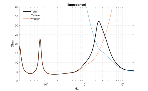

And, given those specs (88dB @ 4 Ohms), how do you think they would pair with the Kaiju? What about two strapped Kaijus?
Right now I'm running a passive preamp into the Kaiju (my DAC outputs 2.1Vrms) and my B&W's are rated at 88dB @ 8 Ohms. Currently, the setup is loud enough for my medium sized room as I have an active subwoofer which helps.
I'm just concerned that going to an 88dB @ 4 Ohms will make a noticeable step down in ouput? It appears the 4 Ohms is a result of an impedance matching circuit as part of the crossover...

If you're currently happy with 88dB sensitive 8 ohm speakers, then 88dB sensitive 4 ohm speakers should be very similar (you'll have to rewire your output transformer for 4 ohm operation though).
A pair of strapped Kaijus would be a very good way to go based on the speaker sensitivity, and luckily the OTs can be wired for 2 ohm operation.

Do you suspect that the 2 Ohm tap is what I ought to use for a speaker pair with these specs?
(Attached the impedance chart)

4 ohm for stereo operation, 2 ohm for strapped monoblocks.

The manufacturer's web site as posted says "sensitivity 88db at 4 ohms" which usually means voltage sensitivity - if it were power, it would be called "efficiency." So the speakers are 3dB less efficient than the B&Ws. A pair of strapped Kaijus into the Buchardts will produce the same loudness as a single Kaiju into the B&Ws.
If it were me, I'd try the single Kaiju first - the 3dB difference is audible but relatively minor. If you feel the need of more power later, you can make the difficult choice.
