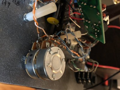

Reply #7 on: October 25, 2018, 10:29:23 AM

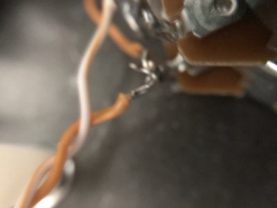

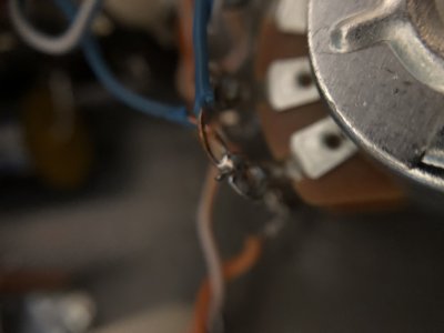

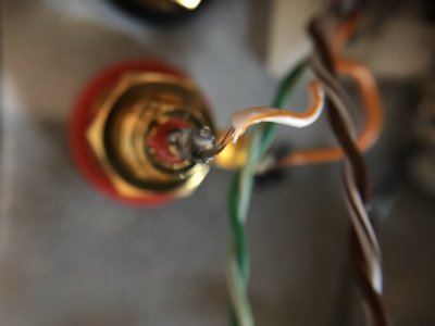

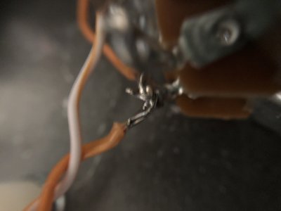

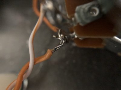

Attaching photos
Jameson O'Guinn
Offline oguinn
    • Posts: 911

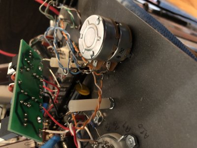

Reply #8 on: October 25, 2018, 10:33:34 AM
Some of those were blurrier than I thought. Here's a clearer view of the pot.

The center pin resistance on the RCA jack indicates a broken ground wire (and I'm starting to sound like a broken record).  What is the resistance between ground and the shell of the right RCA jack?
12V at 8 shouldn't be possible since it's connected to the chassis.  What voltage do you get between whichever terminal you're using for ground and the metal plate?  Do be sure you aren't seeing something like 12mV or 12uV.

What I meant was the resistance between the ground that you've been using for all your other measurements and the metal outside portion of the RCA jack in question (basically any metal part of the jack that isn't the center pin is fine).
