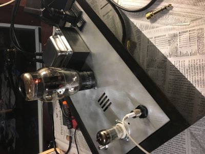

Attaching an image of my build

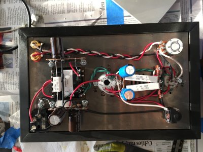

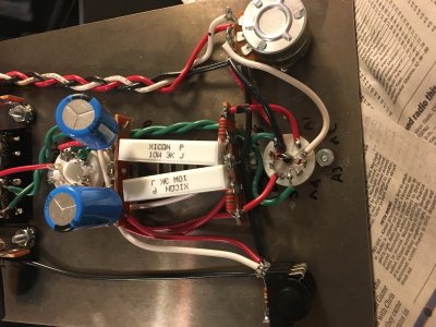

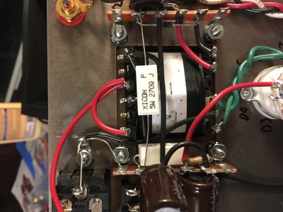

Attaching a few images of the underside.

120Hz buzz means you probably have a connection somewhere that is not perfect, most likely a ground connection.
    • Posts: 20292
Reply #6 on: October 31, 2018, 02:47:27 PM
A loose 220uF cap will also bring the 120Hz ripple way up.
