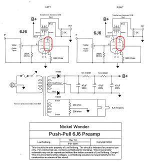

This is a very simple 1 tube per channel preamp that's not too hard to build:
http://wardsweb.org/LSB/11_06_04/6j6.jpg
The Hammond 124B transformers aren't all that cheap, but you should be able to build this with basic parts for under $250.
Deke609
Thanks PB. That's very cool. I really appreciate it.  I quickly reviewed the schematic and the parts/groups are few, so I'm in. And it's a "push-pull"!  Neat.

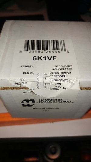

Deke609
PB - I can't seem to find the PT listed in the schematic as Allied part # 227-0001.  Doesn't appear to correspond to any part # on the Allied website. Any ideas? Or this something I should be able to figure out from the schematic?
Derek
    • Posts: 20305
This is what you want.

@PB: I need a little help understanding part of the circuit. I think I've figured out the basics of the DC/B+ part of the power supply and the AC heater supply, as well as how the input signal controls the grid of 1/2 of each 6J6, and then gets amplified by the OT (spent many hours on the latter point: I had no idea that AC and DC can co-exist without interfering with one another in the same wire, and even move in opposite directions - never would have guessed that).  But what I can't figure out is what is happening with the other side of each 6J6. I've circled what's confusing me in the attached pic of the schematic.
I just need a hint about what's involved here so I can go learn about it - Is there a term of art I can read up on to figure this out?
Many thanks,
Derek
« Last Edit: November 03, 2018, 06:48:29 PM by Deke609 »
    • Posts: 20305
It's a differential amplifier.  There's some reading available here, with parts 1-3 available beforehand.
http://www.enjoythemusic.com/diy/1113/vacuum_tubes_part4.htm
