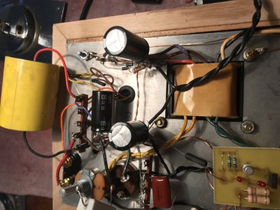

Ancient components and clumsy soldering: I decided to reflow all the joints on one unit to see if that helped.
After doing that, the lowest I could get the hum was 27 mv, which is about 10X what it should be. This is with a shorting plug in the input jack, the amp warmed up for 15 minutes, and measuring VAC across the speaker terminals.

Photos at these links - these are the same that you helped me with in the thread "Paramour 1 with various upgrades" two below this one - except that I have fixed a couple of the issues that you noted, as discussed there:

If the DC voltages are correct and you have 120Hz noise, I would be looking at how well connected your power supply caps are.
I see some "extra" ceramic caps in your amps, they are not anything we ever prescribed.

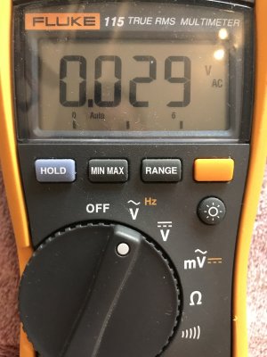

But the hum is still 29 mVAC if I'm reading the meter right - please see attached photo. I hear the buzzing now as a little softer and more trebly when hooked up to the speaker, compared to the unit that still has the mod in it.

On your meter, there is the "mV" setting that will more accurately display the reading, but I'm sure it will be about the same.

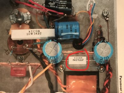

I'm now in the process of replacing the PS capacitors, and I suddenly noticed from the original Paramour instructions and diagram that I don't have the 270 ohm WW resistor connecting terminals 5 and 15 - in either amp.
I'm not sure how I lost this, but could its absence be the source of my extremely high hum level?
« Last Edit: November 18, 2018, 10:49:25 AM by patrickamory »
    • Posts: 20290
Reply #14 on: November 18, 2018, 11:09:40 AM
You have a 270 Ohm 10H choke in that position instead.
