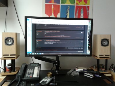

Reply #6 on: November 27, 2018, 07:10:42 AM

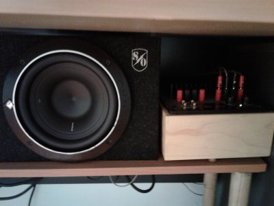

I have the uFonken Plus with FF85wKeN fed by a SEX 2.1 setup on my desk at work. They really do need some help on the bottom end. I use an 8" sub in a small sealed box driven by a Dayton plate amp with the uFonkens running full range.
That being said, the combination is pretty impressive, IMHO. (Ripped vinyl of Pink Floyd's "The Wall" = Brilliant)

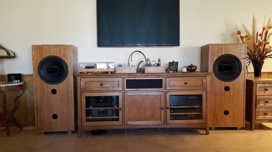

Fostex F120 full range drivers in dFonkenFX enclosures work really well with the Sex maybe a little big for a desk top but I have used them in this configuration and as a main speaker in my lounge. The amount of bass they produce will probably surprise.  Drivers are around $150 each expensive but really very good.
http://p10hifi.net/FAL/downloads/dFonkenFX-0v8-map-020709.pdf

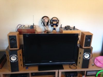

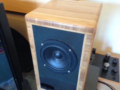

Last year I made some small uFonken desk tops for my daughter with Scanspeak Discovery 10F/8414G10 Full-Range drivers (no crossover needed) these were £119 the pair delivered
The enclosure was made out of a couple of Ikea bamboo chopping boards they turned out quiet nice the Sex drives them well enough for nearfielddesk top use. I picked up one of those little 12w blu-tooth T-amps for about £20 that the daughter uses with them linking to itunes liberay phone/ipad. Works really well.
http://p10hifi.net/tlinespeakers/FAL/box-plans/microFonken-0v9-map.pdf
Couple of old pics

    • Posts: 634
Reply #11 on: November 29, 2018, 09:09:31 AM
BB,
The SEX amp has plenty of power for a desktop set-up with these speakers. Mine's at work so I have to be careful not to disturb those in the adjacent offices.
As I've chronicled before, the sub is a very inefficient Rockford-Fosgate, 8", SVC in a 0.25 cu. ft. sealed box (both designed for car audio) sitting on a shelf under my desk. I'm using a Dayton 100W plate amp. I'm sure a better driver with the appropriate enclosure and step-up amplification would yield noticable improvements, but I'm happy with the way the sub blends with the sats: no distinct "holes", dips or peaks at the hand-off frequencies and from my seat (or even standing with the "Standing Desk" raised) all three do a pretty good dissapearing act.
Maybe I just got lucky...
-Karl
