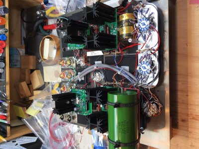

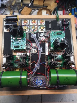

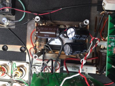

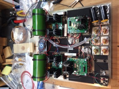

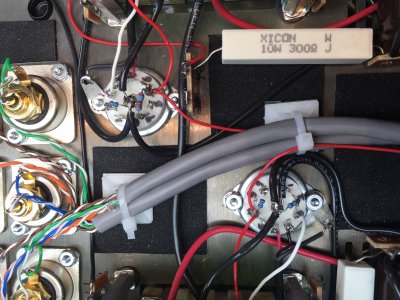

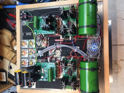

Attached are a few pics of the build.  I counted up and realized this is my 13th audio kit build (numerous AN kits, BH SEX used as a headphone amp, Audio Creative DDDAC, WAD monoblocks, Transcendent tube analyzer and OTL amp, AKSA solid state amp, others) plus 2 Nixie clocks.  Clearly I don't really know shinola or I wouldn't need the help but I'm not exactly a newbie either.  At least I thought I knew how to solder . . . I guess I mention this because I thought with how much attention to detail has gone into the build documentation with BH projects and previous project experience it would be a breeze. . . what could go wrong?  ::)
I didn't realize that building the Beepre and the BeeQuiet at the same time was pushing the envelope . . . :)

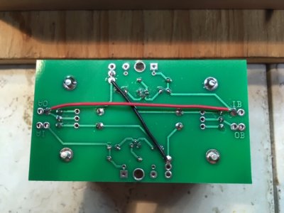

The jumper wires on the high current C4S boards between OA and IB were checked

It's hard to see much in those photos, the resolution is really low.
An intermittent voltage issue like you're describing does sound a lot like a loose or broken wire.

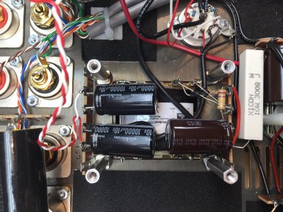

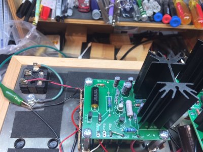

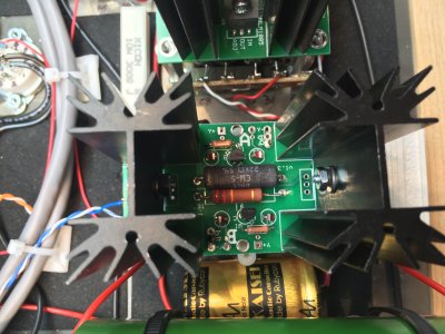

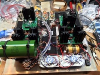

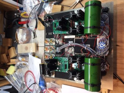

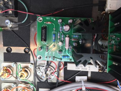

Trying to get good pics is a bit challenging but hopefully these are better. . .

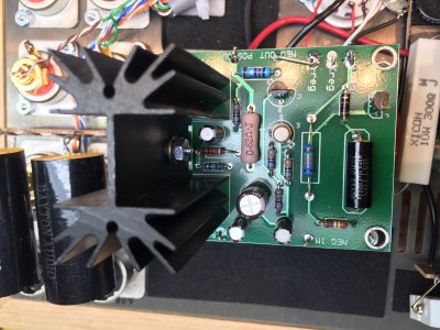

Just a note in the third picture (PS board) it looks like POS OUT could use some more solder and NEG OUT looks like it might need to be re-flowed.

My general sense is that you could maybe use a bit more solder and a bit more heat on quite a few joints. I see what look like joints where maybe the solder flowed well onto the pad but not that well onto the wire that is through the pad.
