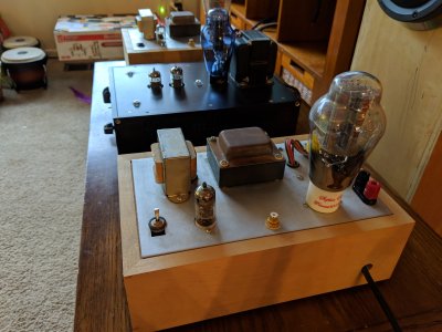

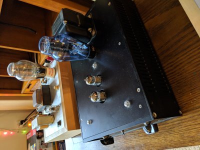

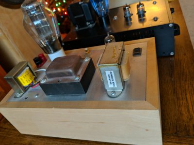

Can you post photos of your Paramours?
Offline matt99eo
    • Posts: 17
Reply #5 on: December 29, 2018, 07:37:59 AM
Here are the photos.
As far as the input to a powered sub, I don't have a low level out of the pre.  I've read the hi level out from speaker terminal is a great option, but it seams like with mono blocks you need dedicated subs for each channel.
That's one reason I am considering the Kaiju in stereo.
Appreciate the tips!
    • Posts: 20330
Reply #6 on: December 29, 2018, 08:02:44 AM
The Stereomour or Kaiju would be a big step up from the performance of those OG Paramours, with the Kaiju providing a bigger increase in bandwidth, power, and overall performance.
