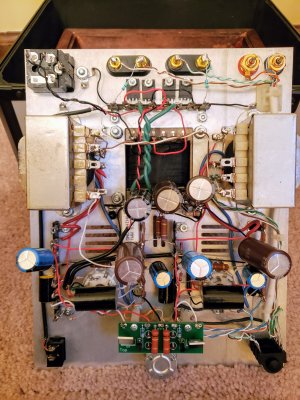

Here is what I have on my phone. I won't be able to post any other pictures until done with work in 3 hours  :(
Reply #5 on: January 04, 2019, 06:31:15 PM
You have a backwards PN2907.
Haha that did it!!
This sounds amazing again!
