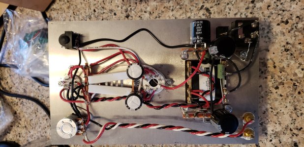

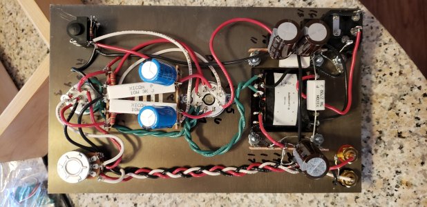

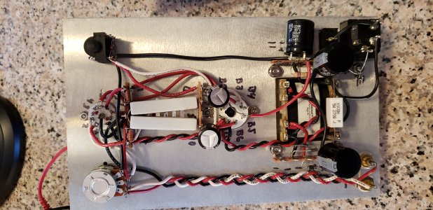

I have an interesting dilemma that I haven't been able to find an answer for searching.
I bought a Crack recently and built it and had a little trouble at first but was able to get it working. It is awesome!
I bought a used one a little after that and it works perfectly.
I just received another, I know, a little extreme of me. What can I say, see the second sentence in this post.
The new one does not work and when I went to start troubleshooting I noticed it has different wiring and label numbers for the terminals on the transformer so the voltage and ohm readings I have in my manual are not accurate.
Then I realized the second one I have is also of this different design. I'm assuming these are the 1.0 versions.
So, my question is where to I get the measurements and troubleshooting steps for these older Cracks that are wired differently than the ones being sold today so I can get the third one up and running?
I've included pictures to assist.
Thanks in advance,
Mike

The only major difference between the Crack 1.0 and 1.1 is the power transformer, the 1.1 using a universal power transformer.
Otherwise the circuit is electrically the same after the transformer & the measurements should be the same.
Usual troubleshooting techniques apply - check wiring, connections, solder joints.
