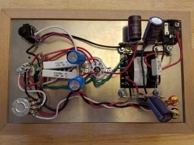

Hi all,
I've just finished my crack build, and checked the voltages.   All of my voltages are roughly double the range specified for the terminals 1-10.  Any ideas what causes this.  I'm suspicious of the smaller tube, as I only saw one glowing point in it light up originally, and now I'm not sure I'm seeing anything glowing in it.

Reply #3 on: January 12, 2019, 11:32:07 AM
It is most likely that one of the black wires connecting to the headphone jack is loose.
It also looks like the wire at A4 is loose, and this would cause one LED to not light up.

Reply #5 on: January 12, 2019, 12:39:05 PM
The black wires that are connected to the 2 6-lug strips, then the headphone jack, then the front 5 lug strip aren't properly connected.  We have seen this exact problem before, and most of the time it is the junction of the black wires at the headphone jack, but it sounds like in your case you need to check all of the places where those black wires connect.  Reheating all of those joints is probably a fine idea.  There are only about five or six joints, so it's not too big of a job.

Reply #6 on: January 13, 2019, 09:28:21 AM
Well, something went very wrong  :(  I was reviewing each of the steps of my work, and was in the process of reviewing the final resistances when something sparked and went POP and a puff of smoke emerged from near my test lead at 12U.  I really don't think the test lead bumped anything else; this seemed rather spontaneous.  I think it might have been one of the two big brown capacitors located there, although it could just as easily been one of the two resistors in there.  Any way to determine which is faulty?  Or do I just reorder a bunch of components and replace them?   Dang.  Thanks for any ideas.   #ampbuildingfail

Reply #7 on: January 14, 2019, 04:32:00 AM
There isn't likely to be anything to replace after this incident, but I would recommend going through and tugging on each end of each black wire back there and up front until you find the loose wire.

Reply #13 on: January 14, 2019, 09:38:44 AM
Getting 2.9K ad 7/9, then an OL reading, then back to 2.9K still supports the statement that there is a poor solder joint on your ground buss.
Reply #14 on: January 14, 2019, 09:58:19 AM
It's difficult to tell for sure from the photo but I thought it looked like terminal 3 might need more solder.
