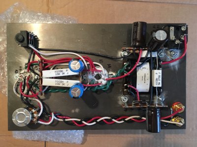

I just finished building the basic Crack, but my voltages are way too high. (Please see below)
The incoming AC voltage measured 244V (UK), so I wired the transformer accordingly. The transformer voltage tests were fine.
Resistance checks were good as well. Everything glows as it should (as far as I can tell).
I followed the instructions from the other thread with almost the same problem (https://bottlehead.com/smf/index.php?topic=11312.0) and reflowed the joints of the black cables. No change to the measurements. I'm hesitant to plug it in again, as the V is well beyond the rating of the caps...
Voltages measured:
1. 182V
2. 388V
3. 0V
4. 389V
5. 182V
6. 0V
7. 243V
8. 0V
9. 243V
10. 0V
Picture of my wiring in the attachment.

Just like the other poster, you have a black wire that's not properly connected.  The high resistance of this connection is giving you those wacky voltages.

I would go back and physically pull on each end of each black wire with your needle-nose pliers to find the loose one.
