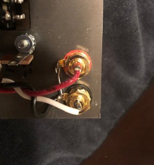

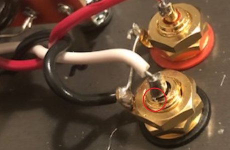

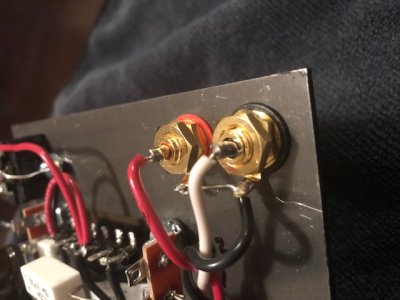

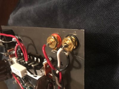

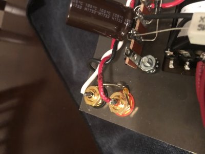

Reply #9 on: January 14, 2019, 03:10:00 AM
Hope these pics work?
    • Posts: 20182
Reply #10 on: January 14, 2019, 04:24:39 AM
Stuff like this can totally short out a channel if it allows the center pin of the RCA jack to touch the outside.
Offline mpribble
    • Posts: 15
Reply #11 on: January 14, 2019, 05:18:19 AM
Thanks, what you think clean it up and solder again?
    • Posts: 20182
Reply #12 on: January 14, 2019, 05:19:57 AM
If you have a pair of side cutter type wire cutters, you can just cut any of that schmoo right off the jack.
