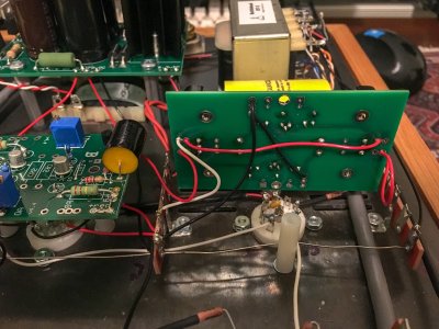

I did a few more checks, will add the info in case it can help.
I can bias both 20 and 30 to ~145V.
All 3 tubes are glowing, but C-side tube is slightly dimmer.
IA of the offending side is 278V, and the center pin of the MJE5731 reads 193V.
I reheated all the joints on that board, and in particular the MJE5731, without success.
Attaching a photo of the underside of the board.
