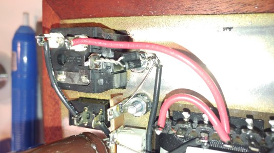

    • Posts: 20253
Reply #9 on: June 20, 2019, 09:15:28 AM
I tried a ground isolator that's just two antiphase diodes between the ground lug on the IEC power entry module and the chassis.  This removed the noise that I was getting from my Powerline ethernet setup completely, and it also proved to be a viable solution to noise from a cheap USB powered DAC that I have.
