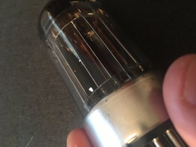

There are some small white flakes stuck to the glass inside and the silver seemed to have moved down a bit (see picture). Anything to worry about?
The tubes have maybe 30-35h on them now. I cleaned the contacts with some steel wool and it seems to run normally for now...

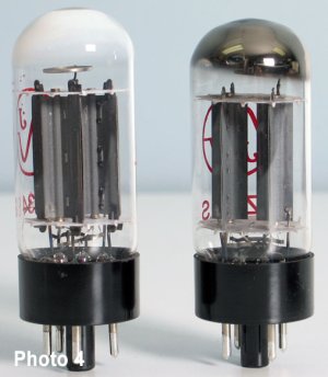

Reply #5 on: February 08, 2019, 04:34:51 AM
The tube on the left is what I'm referring to.  A lot of the time arcing in a tube is from gaseous contamination, which will absorb into the getter over time.
