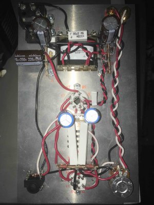

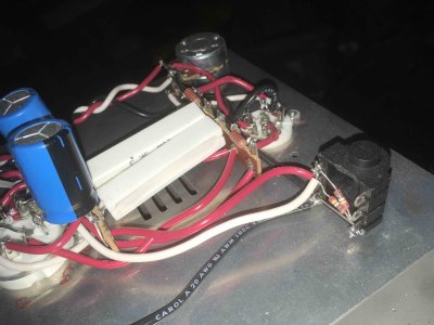

Hey, I bought this kit in late 2015 and finally carved some time out a couple months back to assemble it.  I got together, double and triple-checked, and the resistances check out pretty well.  Once I get to the voltage check the fuse blows whenever give it power.  I've gone through a handful of fuses.  I've re-melted any solider that looks suspect.
 The only thing I did differently from the standard 2015 instructions was the page 19 "Revision 5/6/10:
Making this wire 3” long and connecting it to Terminal 14U instead of terminal 22L may yield more quiet operation."
Can anyone spot anything definitely out-of-place?  I am a moderate-nube at this sort of thing.

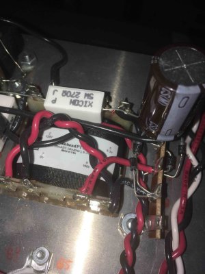

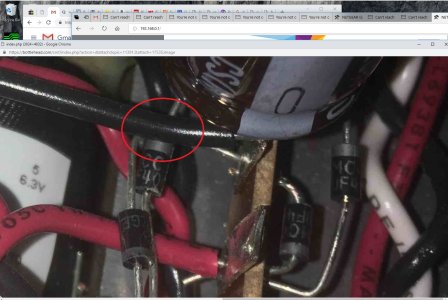

Are the leads of the UF4007 diodes under the black wire in the red circle touching each other?  If so, you'll blow fuses indefinitely until you spread them apart.

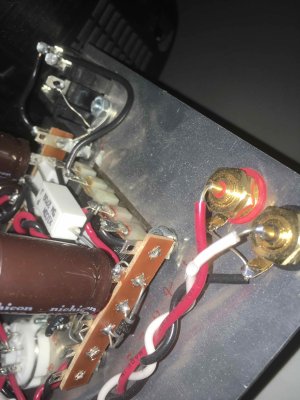

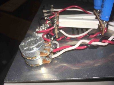

You have one black wire on your headphone jack that doesn't look to be soldered.

Thank you for your response!  I just saw this now, I think I missed an email notification.
You are correct!  The UF4007 diode leads are touching each other.  I'll spread them and plug everything in soon and see how that changes the situation and update this post.
The headphone jack wires appear to be soldered; it must be a bad pic.  Thanks again for looking at this and assessing!

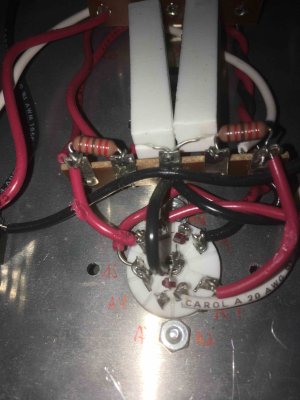

The problem now: the large tube (6080/6AS7) is glowing well, but the smaller tube (12AU7) is not.  The 12AU7 is getting warm, but emanating no glow even after a couple of minutes.  One of the LEDs connected to its socket is lit up (A3), and the other is not (A8).

Your LED at A8 is damaged, which can happen if they are stored for a long time or resoldered after they have been sitting around.  A remedy for this particular issue is to connect a wire jumper between A3 and A8.

Big thanks!  I had some spare LEDs laying around, so resoldered one (actually two; I shorted the first replacement somehow) and they're both glowing, got all the voltages tested within the tolerances, everything is working great! I definitely would have been putzing around with this indefinitely without the assistance.  Thanks again so much!
