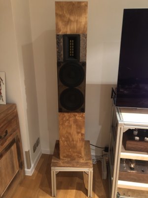

I got some and installed them onto the speakers.  I think they look pretty clean.  Ill get a few more photos and attach them soon.

Wow, those look great!

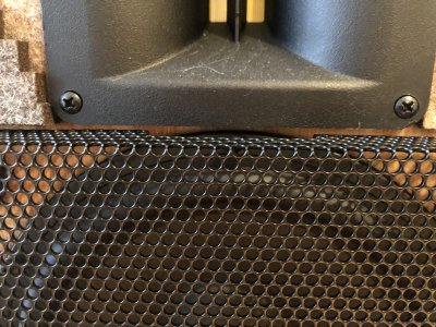

Some more of the great grills.
These are only held on by four hook and pile circles that are stuck to wooden dowels.  If for some reason the cats fall and hook their claws into them, they will probably pop off and not bring the speaker down with them.
The metal is powder coated, and special can and attention was paid to ensure that the metal was kept truly floating.  The metal is not physically in contact with the speaker except through the wooden dowels and hook and pile.  A small cutout was added at the top to ensure that there was a gap between the top speaker, sub, and the grill.

Reply #8 on: March 30, 2019, 04:16:15 AM
I am curious as to why you reversed the pattern of the absorbent material on the inside face next to the tweeter; could you elaborate?
Cheers Hank waiting in Eugene to build my pair.
Offline bombay317
    • Posts: 88
Reply #9 on: March 31, 2019, 12:48:51 AM
 Well, my cat keeps climbing up on top of the speaker and pulling off the felt.  i have to replace it and i just keep sticking it back on the speaker.  sometimes she stares me right in the face when she rips off some of the felt.  I probably dont always put it back in the right orientation.
