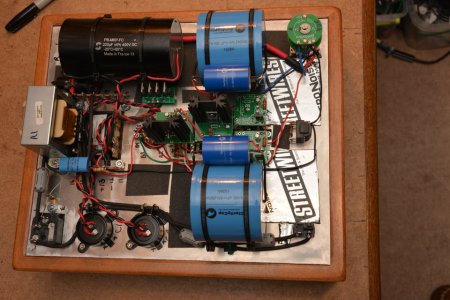

"Upgrading" parts in an amp and tube rolling has it limits. Most gains come from circuit design and Doc B repeats this in a lot of topic you find on this subject. I've gone from Crack to a completely modded Crack (overdone it a bit) to S3X to Mainline and i got confirmation that circuit design beats every parts change "upgrade" anytime.
So, while i do think Bottlehead products have room for "improvement", it is worth it, brings better sound quality and you definitely can learn a lot from upgrading your Crack:--> Don't spend to much money on upgrades/holey grail crazy tubes and start saving for the next step up!
What i would say are reasonable upgrades:
Speedball is the best.
The bridge rectifier as this gives insight in the influence of the powersupply on sound.
A choke in the powersupply for the same reason as above.
You can bypass the last powersupply cap with a film cap (another cheap one).
E80CC/12BH7 tubes with minor changes to the speedball board can be another good learning point.
Output caps with or without bypass can make a difference.

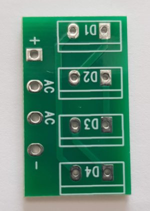

Bridge Rectifier
You don't really need the PCB as the circuit is as you would expect and you can replicate on prototyping board or similar.
NB There are reminders that the tabs on the top of the diodes are live and should not touch anything ever.

I’m going to look into replicating the pcb (thanks ian).  The board looks quite simple but I have zero knowledge on this so will have to do some research.  I’ve looked at your parts guide and I think I’ll order the cree diodes and choke from mouser.  in fact, I've been able to source these from a uk dealer and that has cut the cost down by half.

So, this thread prompted me to order the PCB and Cree diodes, and to break out the soldering iron. The shunt transformer will have to wait until I next order something from Mouser.
Pictures of the PCBare attached to make it easier to replicate the circuit

Doc or PB, does this modification have any theoretical benefit int he Crackatwoa circuit, or does the shunt reg power supply override any perceptible performance improvement?

I have an incredibly hard time discerning any difference in any circuit, though Schottky diodes are wonderful for high current low voltage supplied (DC filament supplies) where their efficiency gives high output voltage with minimal device dissipation.

Thanks PB, in that case I'll probably leave the diodes alone.  I've already added film output caps, upgraded the film caps on the low current C4S, and the TwoQuiet attenuator.  My understanding other component changes likely won't make any sonic difference, but I'm always looking for a good reason to fire up the ol' soldering iron :)

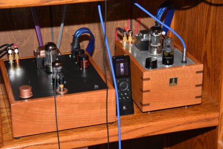

Reply #9 on: March 11, 2019, 03:38:33 AM
confessions of a Crack addict...
I've built 3 Cracks, a Crack-a-2-a, the S.E.X. and a Mainline (and others not headphone related).  Another Crack on the way (they are just way too much fun to build!).  I've heard all three, all three were built with similar upgrades and I've listened to all three in the same rig. One of the Cracks I still have and I refer to it as the BAC (picture included).  You could do more to it but I'm not sure exactly what.
I've had a riot planning and changing and messing with these.  Next Crack will probably get different pre tubes socketed.  I like the brain exercise that goes with the changes.
But...
No matter what you do to that Crack the Crack-a-2-a will sound better.  No matter what you do to that Crack-a-2-a the Mainline will sound better.
Put down the iron, step away slowly and save for the next kit up the line if you want to push your cans to the next level.
But for cryin' out loud have some FUN!!

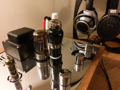

I haven't heard the Mainline, but I always thought the Crackatwoa and the Mainline were more like different flavors, the 'twoa being more warm/euphonic/tubey, the Mainline being the more neutral/transparent.  What do you think, is that accurate?
My mind has already started wandering toward the Mainline, it's only a matter of time...

WOW!!!  Shiny...I like shiny...  But I don't have anywhere near the patience to get shiny.   :'(
I think your description of the two headphone amps is very accurate.  Doc warned me or someone when doing one of the uber Cracks that it would never get to Crack-a-2-a level and he was right.  They are very similar.  Mainline is a entirely different level.
