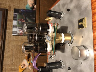

Reply #7 on: February 27, 2019, 07:51:42 PM
Here's 6J5 in my Crack. I like the sound. https://ep1.pinkbike.org/p5pb16745694/p5pb16745694.jpg

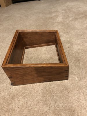

Let's say that I'd like to go a bit crazy on this one.
76's, maybe 37's in the pre circuit.  6J5's for sure if stock on those looks low from suppliers.
How about those 7193's in the pre (not power) side?  I think it would look pretty cool with those Dr. Who dalek's running around.
I'm having a new plate cut anyway and it will be landscape oriented instead of portrait.  I've still got to check room for all of this but I think it might work.  Plate size will be about 10 1/4 x 8 1/2.
The odd plate size comes from a miscommunication between myself and the woodcutter for a prior base and then an additional issue with basic math.
Base.pdf would be "normal" just oriented differently
Base1.pdf could be a new dual tube layout.  Still much thinking needed on that one!

Reply #12 on: March 06, 2019, 07:16:55 AM
Why four socket holes in the base?
Offline ALL212
    • Posts: 542
Reply #13 on: March 06, 2019, 07:21:26 AM
The four holes would be a misguided dream that I could split the 6080 somehow...
Unless there's a miracle it's going to be a three holer at best.
Base3.pdf is probably fairly realistic
« Last Edit: March 06, 2019, 07:29:01 AM by ALL212 »
