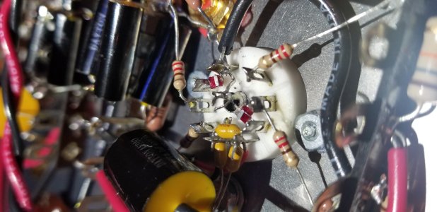

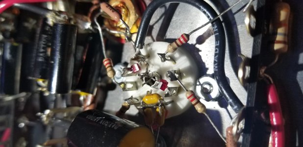

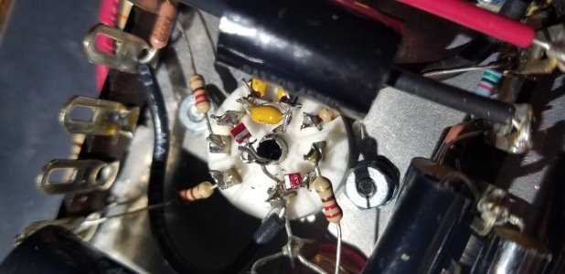

Those low voltages suggest the relevant LED is shorted; the flickering suggests a poor solder joint making intermittent contact. PB, who does most of the repair work and thus knows the most about fixing problems, will probably chime in soon, but meanwhile see if you can get clear photos of the tube sockets, showing the individual pins - especially the LEDs. That will give him a leg up on diagnosis.

Thanks for the quick reply and heads up on the photos!

A flickering LED, as PJ mentioned, indicates flaky connections or an LED that's actually damaged.
You could conceivably have some glowing LEDs and low plate voltages from flaky solder joints elsewhere in the circuit causing the bias to not be set by the LED alone.

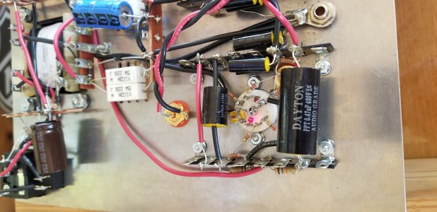

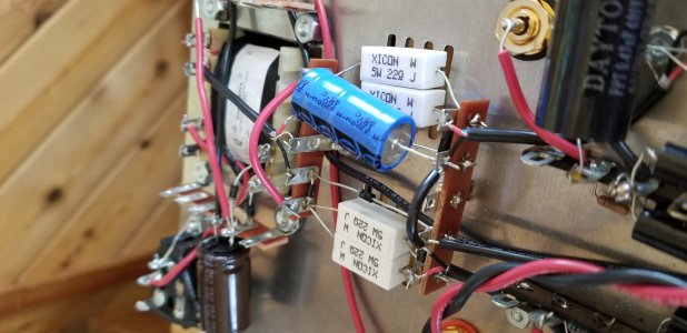

Can you post a few more photos of your build?
What DC resistance do you get at 36?  How about 34?

I got 0 for both 34 and 36. Sometimes when I checked them they would fluctuate under 10 mV, but for the most part they would both read 0. I've noticed today that the LED attached to A3 has been solid. Haven't seen it flicker at all. Let me know if you need a more specific pic of something. Heading to work soon so won't be able to reply until later tonight. Thank you for your help so far!

Terminals 33-37 are badly in need of more solder on the upper lugs and more heat on the lower lugs.
