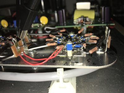

I have now re-flowed the lower lugs on both course and fine and also the lugs on TRS and XLR.
The the volume control has issues. the volume jumps to max volume when I rotate either course or fine.
- Regarding the AC measurements, I was not able to get any reading on the lower lugs on the coarse switch. I played a 60Hz tone and turned off the amp V~ was always 0. I must be doing something wrong there.

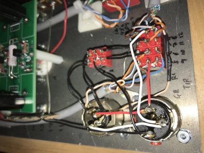

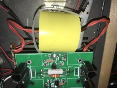

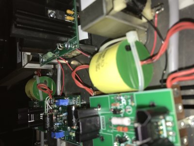

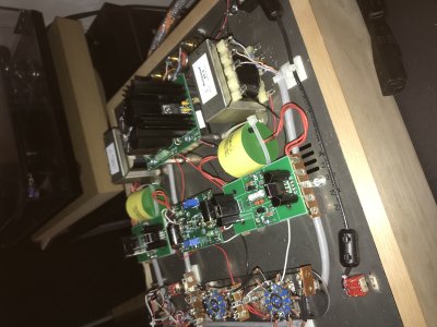

Reply #3 on: March 08, 2019, 11:13:00 AM

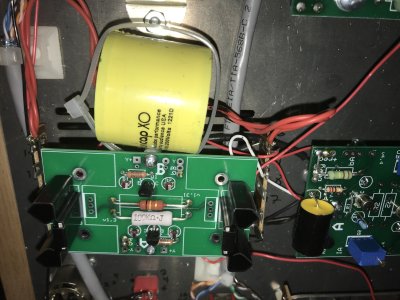

Here are some photos. Let me know if you want more specific ones.

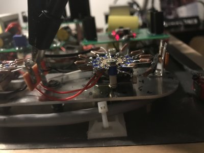

Reply #4 on: March 08, 2019, 11:15:15 AM
2/3

Reply #5 on: March 08, 2019, 11:18:38 AM
I am sorry for the picture quality. I will be able to take better ones tomorrow if needed.

Reply #6 on: March 08, 2019, 11:39:47 AM
Is this on both channels, or just the working channel?  This would tend to suggest an open ground on the coarse attenuator.
What is the lowest range for AC voltage on your meter?  Your phone will probably put out 200-300mV, so if your meter only has a 200V and 500V setting for AC voltage, these tests won't be possible.

I think you have an issue with the attenuator that was exacerbated during the installation of your Auricaps.

Reply #9 on: March 09, 2019, 04:40:02 AM
I gave you a path to take by measuring AC voltages.  Perhaps it would help if you let us know what multimeter you have?
I generally do not recommend resoldering the connections on the switches themselves, as those switch lugs don't take much heat to solder properly.

Reply #10 on: March 09, 2019, 07:28:42 AM
When I play the 60Hz tone on my iPhone 7 at full volume,
The mainline is connected to power and turned off.
Both Course and Fine switches are set to 0dB
The lower lugs on the course switch give me (White)>97mVac and (Red)>98mVac
The meter is on Auto V~ shows 0,097 and 0,098
I also measured the RCA socket where the source it connected.
L= 154mVac and  Right = 155mVac
The meter is on Auto V~ shows 0,154 and 0,155
I have 2x budget multi meters.
Branford MS8321D
Neoteck Digital Multimeter Pocket Multi Tester 2000.
In case this is relevant.
Resistance Check
15 = 210ohm
25 = * ( Think this one should be between 210-220ohm)
The capacitor I was working on when the problem started is connected to 25 and 30
I did put the Dayton back in between 25 and 30, but that did not resolve the problem.

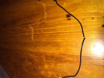

I have solved the problem.
The Black wire from OT-3 on C side towards 26U was broken.
It was hard to see it because it still hangs together on the sleeve but the wire was broken apart.
I hope that its OK that the cable I used for replacement is a little bit thicker.
Thanks for you help.
