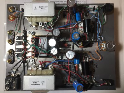

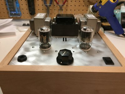

And wow - what a difference over the stock headphone amps in my solid state preamps. Really enjoying this!
This question has probably been answered already, but where would I buy replacement tubes? 6FJ7's - sorry, new to tube amps in general and just want to make sure I get quality replacements. I would like to buy a couple of sets to ensure I have some on hand in case one gets blown or wears out. Also, I noticed the two that came with the kit are not the same brand (GE and RCA) - I take it they don't need to match?
(added some pics - came out real nice, thanks to terrific instructions!)

Nice, clean build. Enjoy the S.E.X. There is something magical about these little amps.

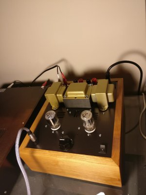

I am glad you started this thread!  I just finished my S.E.X. as well.  I am really happy with how it sounds.  I have heard heard a few  Schitt and Audio Gd amps in this price range but I have to say that even the stock SEX amp punches well above its weight.   I have the C4S upgrade parts sitting on the table and I'm wondering how it will improve on the great sound I already am getting.  I have tried the SEX so far with Focal Clears, Audeze LCD 2.2s, Audeze isine 20's, and some Massdrop Fostex TR-X00s.   I felt like the LCD 2.2s and Massdrop cans sounded great.  The LCD 2.2 is pretty inefficient though.  It's a good thing the SEX has so much power on tap.  The isine 20 didn't fare so well.  Too much midrange emphasis with a very metalic sound.  The Focal?  All I can say is wow.  They just sound so meaty, so clean throughout the audible frequency spectrum.  I have heard the Focals thru the Woo Audio WA22 and the sound is very similar to me with the SEX.  Not bad considering the Woo is about $2500.
    • Posts: 632
Reply #11 on: March 26, 2019, 02:56:05 AM
Looks great, the chokes and transformer in gold work well with the black plate. Sounds ( :p ) like you have the HP bases covered. And with what the S.E.X. amp can do with the right speakers it is an even bigger bang for the buck.

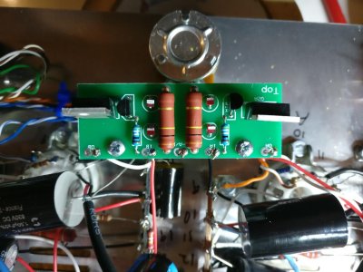

That sounds like a good plan, Paul!   I have always wanted a 300b amp, the Kaiju may be just the ticket.  I just completed the C4S upgrade with the SEX.  I noticed when I did the voltage checks afterwards that there was a discrepancy between the OA and OB values.  I got 48 V for OA and 72 V for OB.  Is this a wiring issue, transistor issue or is this just normal tube to tube voltage variations?  All four LEDs light up.  As far as the SQ, it is fabulous.  IMHO, it sounds even better than stock with a more refined presentation.  More resolution, images are more distinct, bass is tighter and better defined.  All in all, I am very pleased with the upgrade and overall performance.
