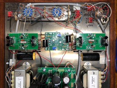

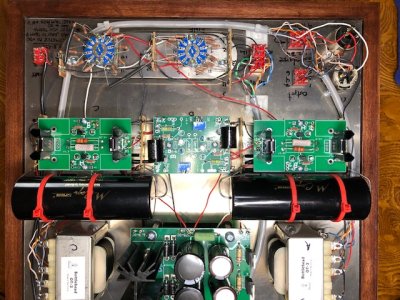

I installed a pair of 10uF Mundorf Supreme filter caps today.  Here's the before and after.

Can you respond with the differences you heard with this capacitor change?
Offline jtori
    • Posts: 125
Reply #2 on: March 15, 2019, 10:35:00 AM
Sure.  Mind you, I just performed this mod yesterday so my impressions may not yet be fully formed.  In initial assessment, however, is that things sound slightly smoother and there is a little more bottom end.  To me, it's an improvement.  Listening with the Sennheiser 800S, I'm in a happy place.

The Mainline is transformed (capacitated?).  I've listened now for a few days and can honestly say I'm blown away by what the Mainline is capable of.  I've listened with both the HD800S and the ZMF Auteur and am just intoxicated by the sound; on both phones it is captivating:  Smooth but revealing.  Possessing punch when required.  Thanks, BH, for allowing room to accommodate this upgrade!

I also replaced the stock output caps with the same Mundorf Supremes. Honestly, I did not detect any difference (using HD650's). When I replaced the electrolytic output caps in the Crack with film caps I could easily hear a difference. My theory, applicable to me, is that going from one type of film cap to another probably won't make any detectable differences, especially without any proper a/b testing. That's a good thing for my wallet.

No. I use the Mundorf Supreme 10uf SGO's in my Mainline but have to warn you that they don't fit as nice as these do.
They are 1-2mm too big in diameter to fit between the boards and the chokes.
The sound is better / different but not worth the investment imo.
A pair of Russian 10uf K75-10 250V could be a good and cheap alternative.
