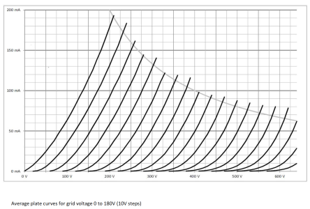

I was sent the plate curves for the tube.
I'm still thinking about doing this, though not yet sold on it.
