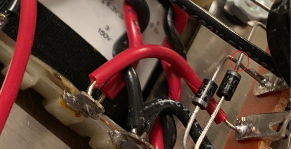

If these two diode leads touch, you'll have other problems.
Can you measure the DC voltage at A8?
Offline johnnys
    • Posts: 4
Reply #2 on: March 27, 2019, 09:22:20 AM
Thanks for your reply, Paul.
Yes, those diodes were touching, I’ve separated them at the point that you circled.
My DC voltage at A8 is 8.2.
    • Posts: 20297
Reply #3 on: March 27, 2019, 09:53:42 AM
You have a damaged diode going to that terminal.  You can run a wire from A3 to A8 and your amp will likely work properly (and your voltages should fall into line).

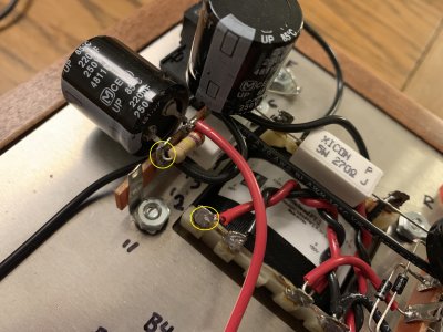

Reply #7 on: March 28, 2019, 03:24:37 AM
I'm thinking I've got some cold solder joints,
Hi John - I'd try redoing the solder joints at and around the PT. The 2 circled below look particularly suspect.
Good luck!
