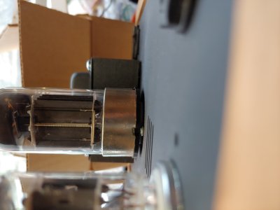

After some poking around, I believe the issue may lie with the 6080 tube. Placing the chopstick on or around the tube produced a vibrating feeling that seemed to line up with the frequency of the buzzing I'm hearing. Also, the 6080 tube seemed to get fairly hot after a few minutes of use.
Upon further inspection of the tube, is is possible it's not actually seated all the way? I can see a gap between the bottom of the tube and the socket, and the tube can't seat any further down because it's hitting on the 2 screws securing the socket. I attached a picture to try to clarify.

If the 6080 doesn't get hot after a few minutes of use, that would be a problem.  The tube is fully seated, that isn't a problem.
