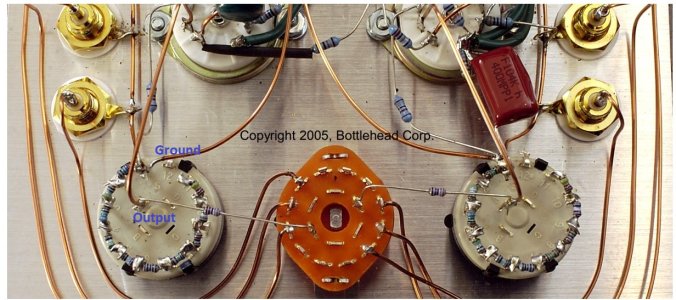

My Foreplay volume controls have developed static when turning them up or down. There is no noise when I set the volume and leave it. I did not build it...John Tucker built it back in 2002 along with my Parabees. I took the Foreplay to a trusted tube stereo repair guy in town and he cleaned the controls. It made no noise for a couple of weeks, and now the static is back.
I've done some reading on the forum, seems my options are to have him take the attenuators apart, clean them better and try to improve the contacts, or buy new controls such as Alps or Goldpoints.
My questions are:
1. Is it worth taking them apart and trying to make them work better?
2. Can I have him build new attenuators exactly like the Sweet Whispers with new parts? Opinions on which resistors and switches would be appreciated.
3. Is it easier/cheaper to buy new ones such as Alps or Goldpoints?
I LOVE the way my system sounds...so whatever I do, I want it to be as good or better than it is now.

Just replacing them with new level controls will be far easier and should be less expensive.

They are 15K units, but 10K mono attenuators are going to work just fine.  In the stock configuration, just the ground and input holes would be use on aftermarket attenuators.

You'll need a small flat file to make some notches in the top panel, but this is still easier than pulling apart the old switches.
