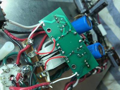

Reply #1 on: April 06, 2019, 06:04:39 AM

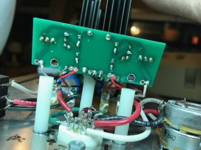

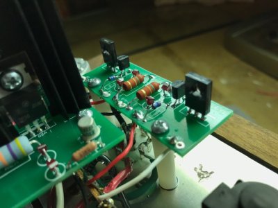

Would it be possible for you to post some photos of your board?  If you can unscrew the screws that hold it down, you should be able to take a photo of the top and bottom without pulling it out of the circuit.
Offline Justin
    • Posts: 17
Reply #2 on: April 06, 2019, 07:48:50 AM
Sure, see attached.
FYI the middle lead of one of the MJEs broke when I was removing them to fix the orientation but I feel like I was still able to get a decent connection when I re-soldered it to the board. I don't think that's causing my problem but who knows.

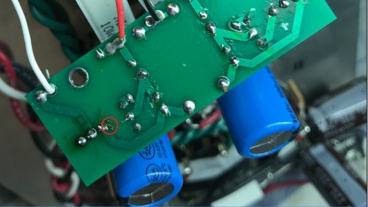

Reply #3 on: April 06, 2019, 01:34:30 PM
I think I see some of the board trace that has come off in this photo.  This can happen without the proper tools if you try to pull the transistors.  To be honest, I would contact replacement parts about just getting a new small board plus parts, as this one is likely beyond being salvaged.

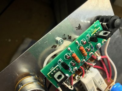

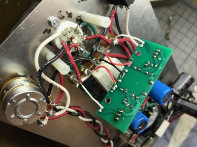

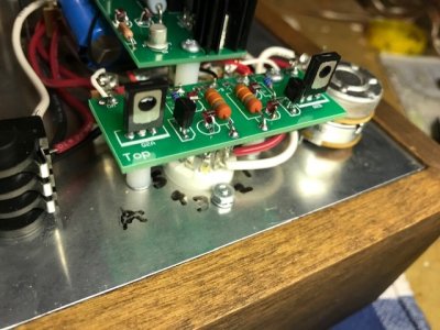

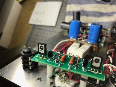

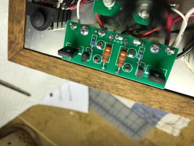

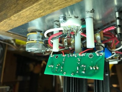

Reply #14 on: April 24, 2019, 02:24:29 PM
No, there's a bigger underlying issue here.
Can you post some new photos of the top and bottom of the current small PC board?
 Do you still have the 22K resistors that you removed when installing the small PC board?
