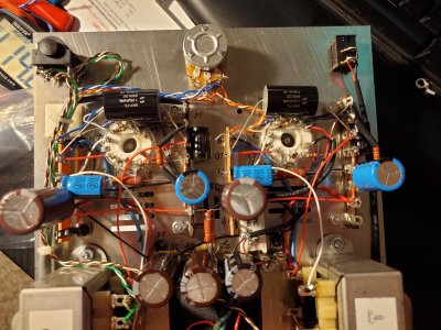

I just finished my SEX build, but have a voltage issue.
Lead 17 is reading around 145 mv
20, 21, and 24 are all about 20 v higher than what the manual specifies:
20 - 405 v
21 - 420 v
24 - 400 v
Everything else seems to check out... I attached some pictures to see if that might help.

Reply #1 on: April 14, 2019, 05:14:33 AM
What is your AC line voltage and which range did you use in the manual?
Offline Kevin
    • Posts: 34
Reply #2 on: April 14, 2019, 05:50:24 AM
AC line is 120 V. I used 115 to 130v.
Reply #3 on: April 14, 2019, 06:16:05 AM
What DC voltage do you get between H4 and H5?
Offline Kevin
    • Posts: 34
Reply #4 on: April 14, 2019, 06:23:12 AM
I'm getting 6.39 v between h4 and h5
Reply #5 on: April 14, 2019, 06:24:32 AM
Alright, my thinking was that low voltage between H4/H5 could cause a drop in the current the circuit draws, and that would pop your high voltages up a bit, but you have plenty of voltage there.  I suspect that there are no issues here, and that you might find that your wall voltage is wandering a little bit between 120V and 125V.
Offline Kevin
    • Posts: 34
Reply #6 on: April 14, 2019, 07:36:31 AM
Alright, I just plugged it in, and everything seems to be in working order. Headphone and speaker out seem to be working great! There some noise in one channel, but it seems to be tube-related, since swapping the tubes switches the noise to the other side.
Just for my own learning... But why would there be such a large difference between what I'm getting at terminal 17 from the expected reading and still be in working order? The wiring category is for 115v - 130v, so I don't see how the fluctuation of my AC line between 120v and 125v would cause such a large.
Thank you very much for your help!
Reply #7 on: April 14, 2019, 07:46:06 AM
Can you measure the DC voltages at 13 and 31?
Offline Kevin
    • Posts: 34
Reply #8 on: April 14, 2019, 07:55:54 AM
13 - 392v
31 - 3.02v
Reply #9 on: April 14, 2019, 07:58:46 AM
Sorry, I meant 13 and 21.
Offline Kevin
    • Posts: 34
Reply #10 on: April 14, 2019, 07:59:58 AM
oh, 21 is 420v
Reply #11 on: April 14, 2019, 08:06:34 AM
The common B+ rail leaves terminal 33, then splits off to both channels. One side is terminal 13 and the other side is terminal 21.  Can you measure the DC voltage at 33?
These should not be so far off but understanding which one is the problem will depend a little on what your raw high voltage rail looks like.
Offline Kevin
    • Posts: 34
Reply #12 on: April 14, 2019, 10:39:30 AM
I'm not sure what happened, but the issue went away... I didn't do anything at all other than play some music through it. But here are the new readings as of everything working. Terminal 33 was 416v. Thanks again for all your help!
