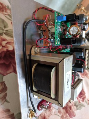

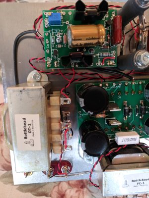

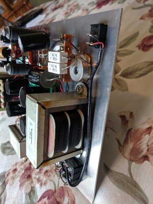

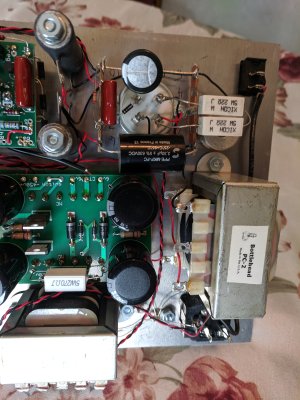

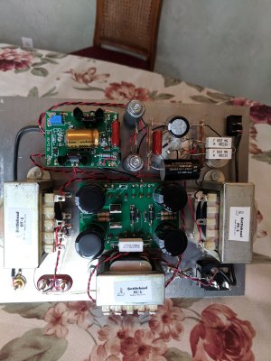

I would post photos of the top and bottom of the Paramounts, as there are some mods that may need to be undone.
How fresh are the batteries on the Quickie?
My experience with vintage Fisher gear is that when you pile up 12AX7s, the high frequencies soften considerably.  If you happen to have full range drivers that have rising response, the soft high frequency response of the Fisher may counteract the rising response of the speakers.
It's a lot of speculation without more details.  Dead/dying tubes will also sound really harsh, but I wouldn't be running off to buy new ones until you test the ones you have.
Offline brucef
    • Posts: 55
Reply #3 on: April 25, 2019, 09:34:19 AM
Thanks for the responses. I will try new batteries in the Quickie to see if that helps. I am assuming that the Quickie should play well with the Paramounts. Here are some pictures of the amps. I am not really familiar with the 300B tube. Can it be tested ona standard tube tester. This is all new to me. Thanks

Everything looks bone stock and well built on the amps, so that's a good start.   The amps will take about 30 minutes to warm up.
