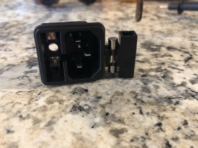

Would you be able to emphasize on this a little more? i'm not quite sure what you mean. Here's a photo of the fuse in its location.
Reply #3 on: April 28, 2019, 06:10:10 AM
Since you aren't testing the voltage at the switch, you would never know whether or not it functions.
Next I would try measuring the AC voltage between where the red wire hooks up on the IEC power entry module and the metal strip across the inlet from it that doesn't have a connector on it.

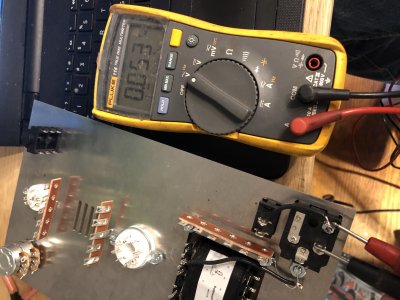

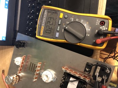

I just took two different voltage tests, and now its down to .05 v from 5v AC. here are some photos.
Reply #5 on: April 28, 2019, 09:00:45 AM
The red lead of your meter is not plugged into the correct hole.
Offline MikeZalewski
    • Posts: 12
Reply #6 on: April 28, 2019, 09:13:55 AM
My bad, i finally got a reading of 118 volts from the flat piece to the tab which the wire goes from. Am i good to go now?
Reply #7 on: April 28, 2019, 09:15:02 AM
Yes.
